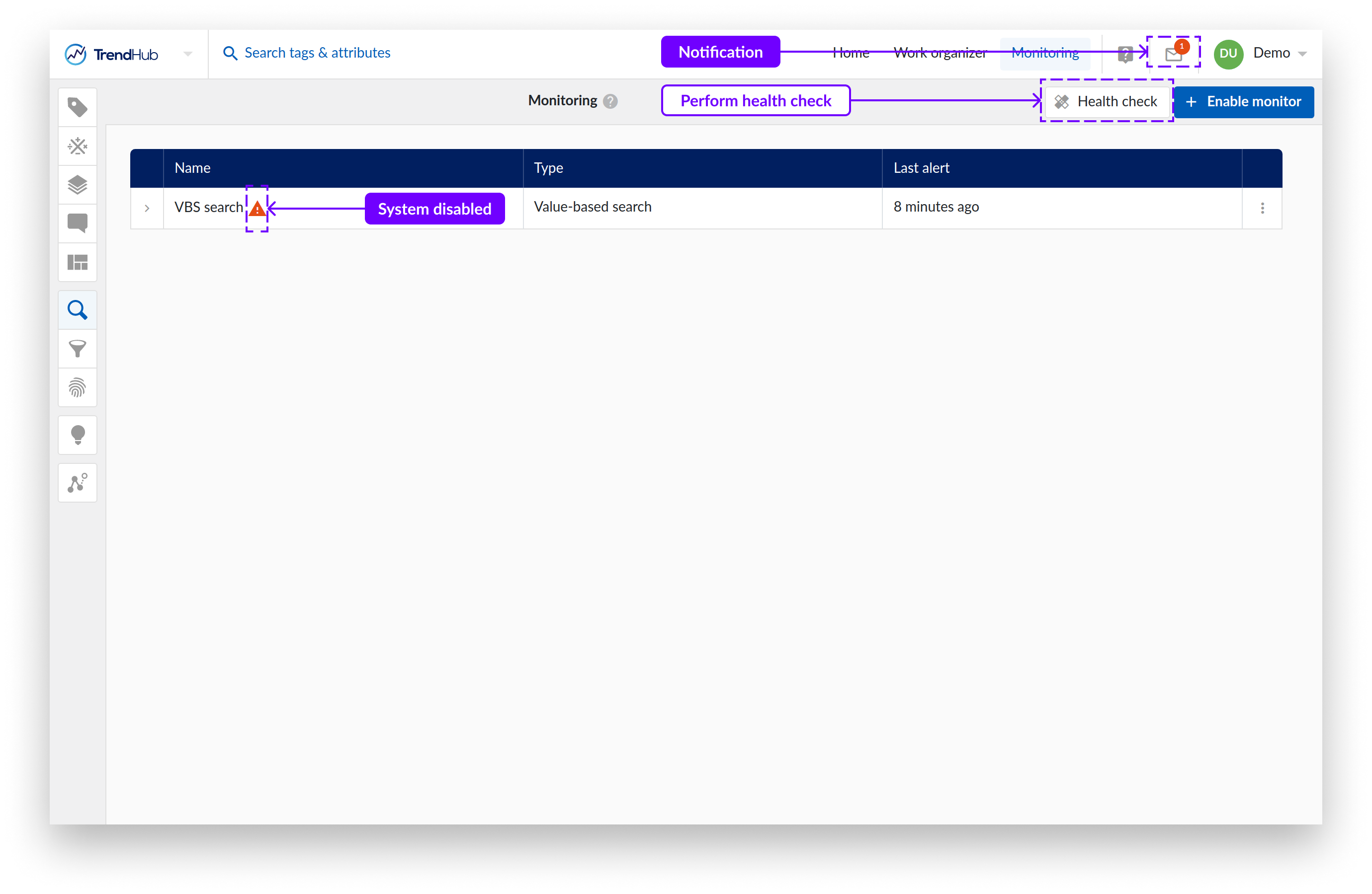

System-disabled monitors
Whenever issues are encountered during the automatic monitoring process the respective monitor will be set to system-disabled, which is indicated in the monitoring overview by a red warning icon.

Having this setting provides you the correct overview of the status of your enabled monitors, i.e. which are in a healthy state and which are not. For each monitor that goes to System-disabled, a notification is sent out describing the root cause.
TrendMiner will not check for results for system-disabled monitors.
Whenever tag accessibility issues are restored or the failing monitor is edited to use a valid and existing context type, you can re-enable all system-disabled monitors at once by clicking the health check button in the header of the monitoring and alert overview page. When the health check is finished, a notification is sent out indicating the number of monitors that could not be enabled.
