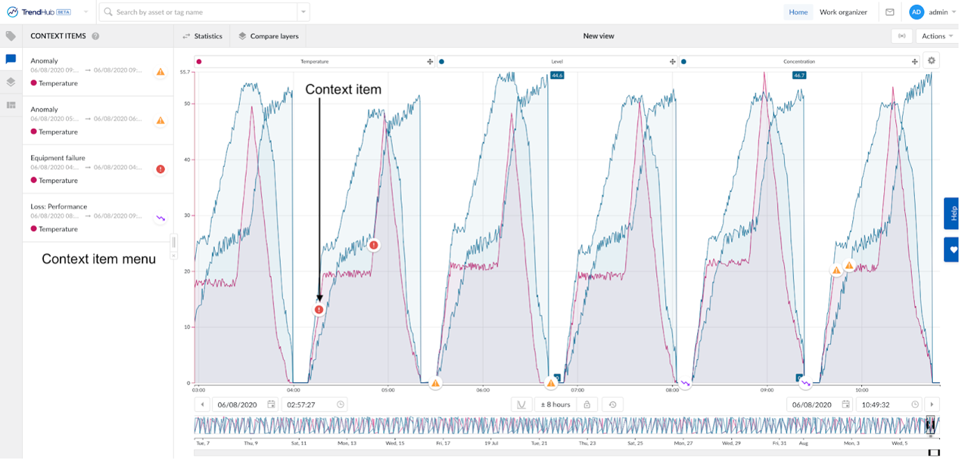

The Context Item Menu
The Context Item menu shows an overview of all context within the focus time range of all visible tags.

The Context Item icon
will now display on the TrendHub menu; click on it. Once selected, the Context Item menu is revealed

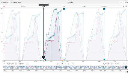

When creating context over a period in the focus chart, the scooter will present range information that highlights the start and end of your selected period. On the chart two icons for this item will be displayed, highlighting the beginning and ending of the event.

Under plot settings, click on the option for "Context items". This will display the items you have in your plot. If this setting is not turned off, no item will appear in your plot. If you have many items in your plot, it can be useful to turn off this setting so that you have a clear view of your charted data.

Open the context item menu by selecting the "Context Item" button in the TrendHub menu. Click on an item or item icon in the menu.
In the context item menu the items display item type (title and icon), start and end time of the context item, tag or attribute name. The items are date ordered.

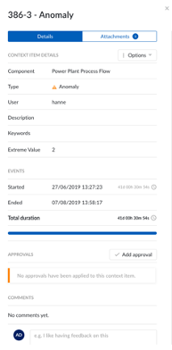

In both these instances a side panel will appear from the right of the screen. The panel contains the context already created for the item.
In the newly opened context panel you can add further context to your item, including;
Comments
If your item is a period event, you can also identify the period durations of each event within your context item panel; both numerically and visually via a blue bar. This duration information is very useful when targeting cycle times, for example batches that took longer than 2.5 hours. The size of each bar segment correlates with event duration; total duration being the sum of all events in a given process, is also available.

When a grey area is selected and a context item added, two context item icons appear. One at the beginning of your selection and one at the end.When you hover over the first of two paired items the intervening period is highlighted over the rest of the trendplot. This feature is particularly useful when your chart is filled with context items.

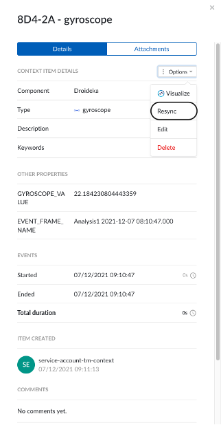

You can actively refresh context items from the source system if you believe that something went wrong, for example, the context data got corrupted or becomes outdated.
At any time, you can align details of your context items with your source data, via the detail panel of any context item that originates from an external source system. When you decide to resync, a source system check is conducted to identify any updates on the original event frame. Any new updates will be identified, and then reflected into TrendMiner.
To resync an item:
Open a Context View.
Select a context item and open the details panel.
Click on the "Options" button.
Select "Resync".

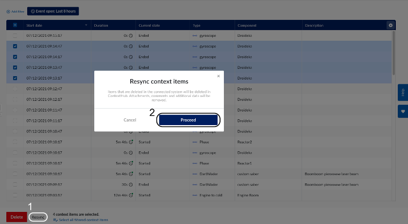

Bulk resync
There is a bulk resync option available to ContextHub Administrators. This can be done within a ContextHub view, in table mode.
Click on the check boxes of the items of interest in a Context View.
Then click on the "Resync" button located at the base of the table. A pop up will appear.
Click on the "Proceed" button.
Resync jobs completed are highlighted in the notification center. Notifications will emphasize whether a synchronisation succeeded or not, and whether items were deleted or updated.
