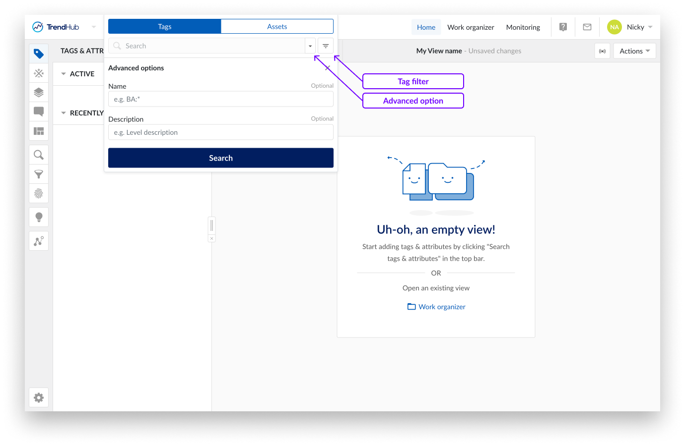

Advanced search
When the tag tab is opened in the tag and asset browser, you will see a dropdown button next to the input field. Once this button is clicked, it shows the 'Advanced settings' for the tag search where you can look for a tag with a specific name or description, or both.  Once your desired name and/or description are entered, clicking the 'Search' button returns the results matching the name and description field.

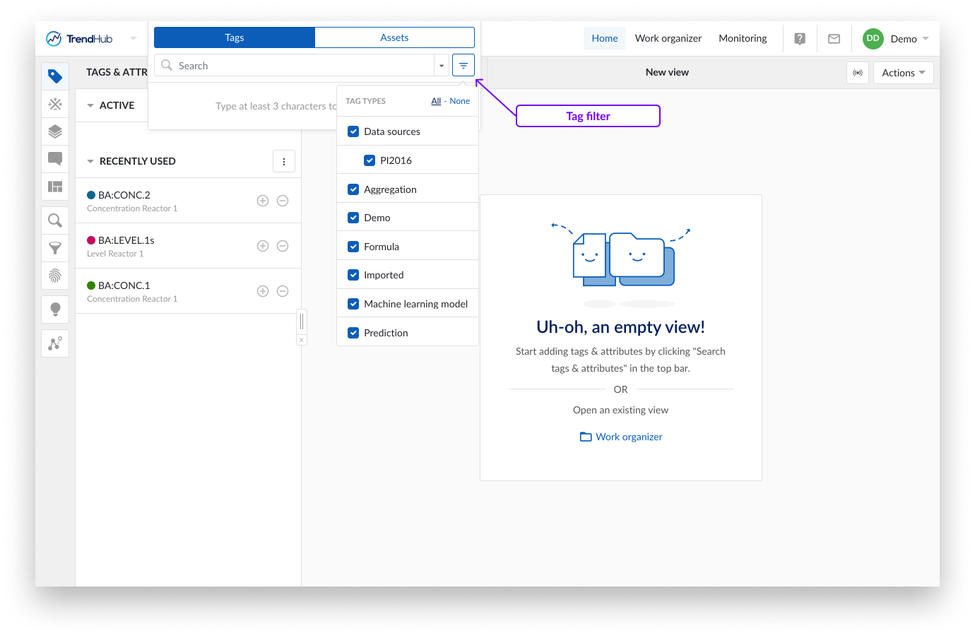

Next to the option to specify a name and/or description, you can also filter on tag types. This filter option is available on the right of the earlier discussed advanced option button. Clicking this tag type filter button opens a small popup with all available types you have at your disposal.
  • Data source tags, an overview of time series archives which are available to you.
  • TrendMiner only tags, like formula tags, aggregated tags, demo data, and many more.

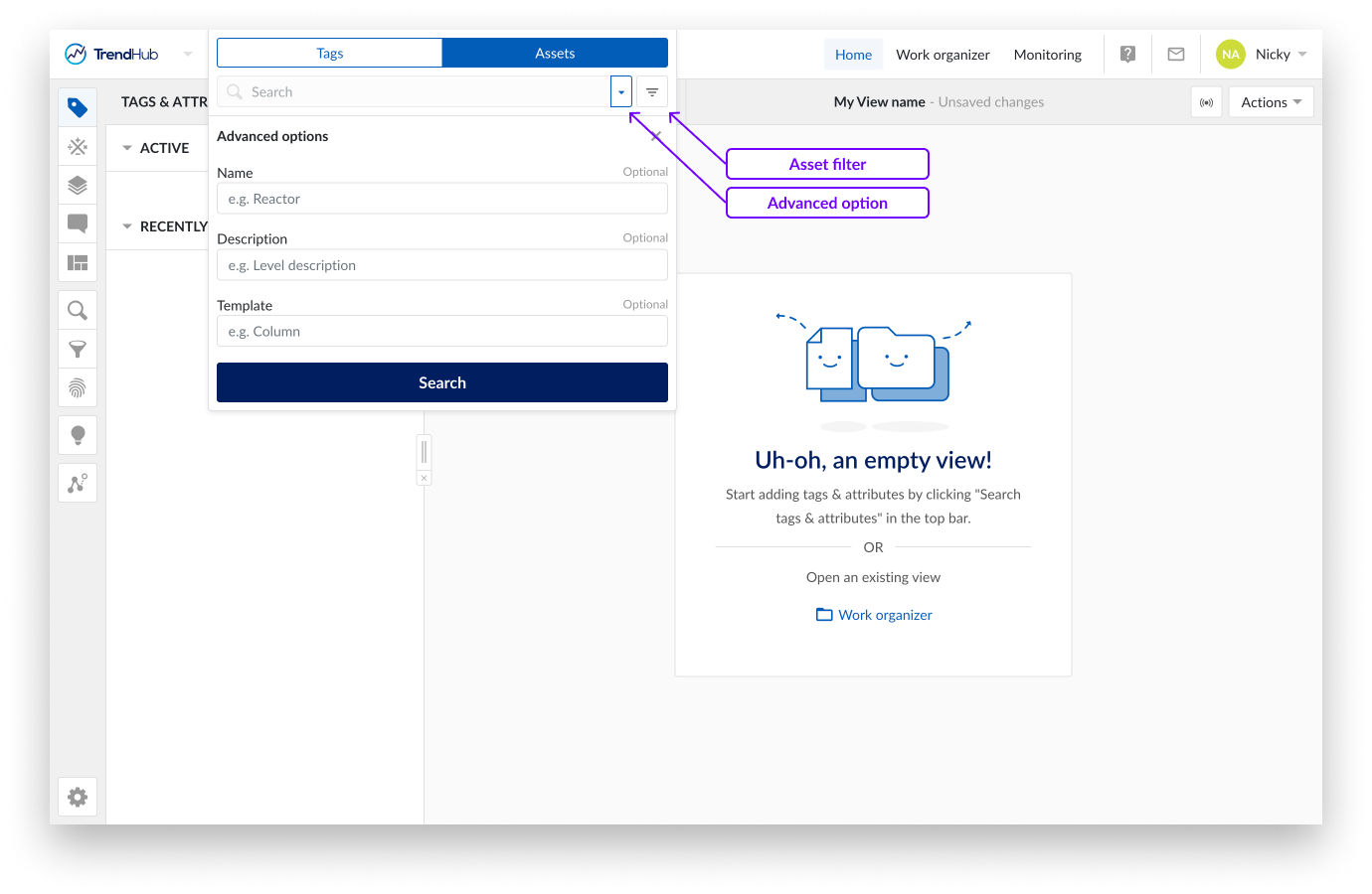

When the desired attributes cannot be found by navigating through the list or by searching for them using the basic search, you can do an advanced asset search where you define a specific name, a description of your assets or attributes, or a template name. These fields are optional, meaning not all are required to be filled out.
The advanced asset search is opened by clicking the button next to the input field, which is the same as with the advanced tag search. When the button is clicked a similar dropdown is seen with three input fields. Once the desired fields are filled out and the 'Search' button is clicked, all related results are shown.

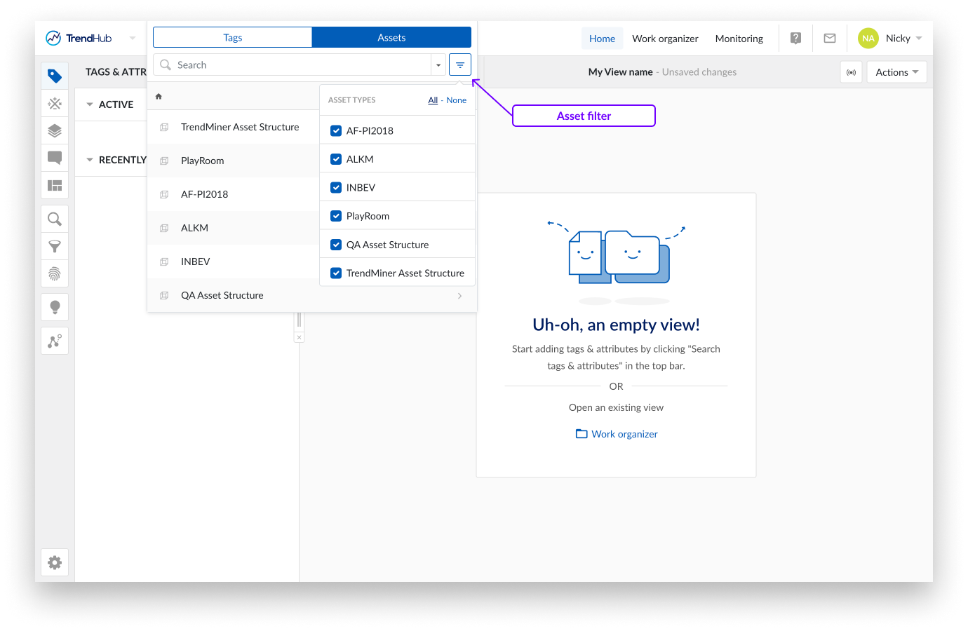

On the right of the "advanced" option button, we have a filter button where you can also filter on the available asset trees.
