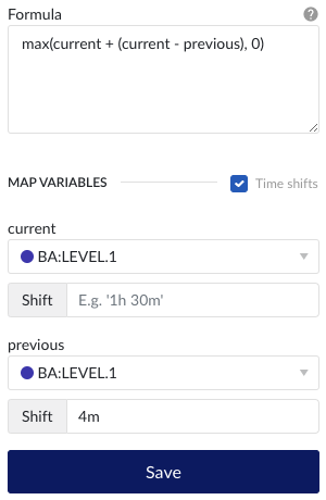

Figura 3. Linear extrapolation example
[en] Linear extrapolation example
We estimate what the level will be 4 minutes. Since we know the level cannot be negative, we use the max function to have 0 as the lower limit.
