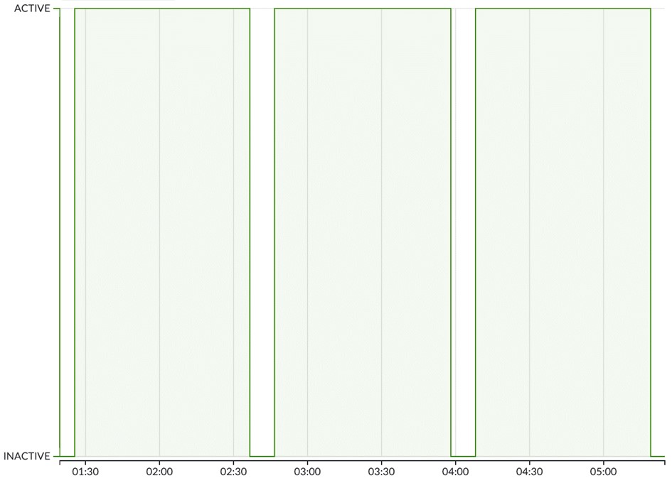

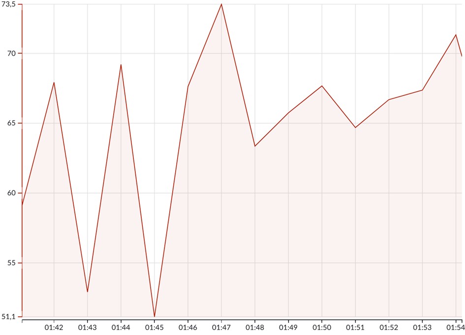

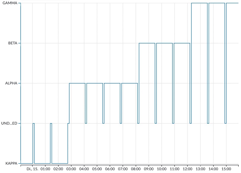

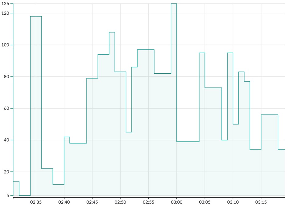

Examples of Tag Types
Analogue tag type
Analog
Discrete
Digital
String
