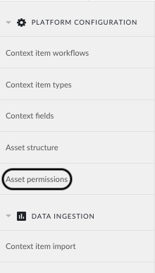

  1. Click on "Configuration" in the top right of ContextHub.
  2. In the platform configuration menu select "Asset permissions"
    The asset structure tree will open.

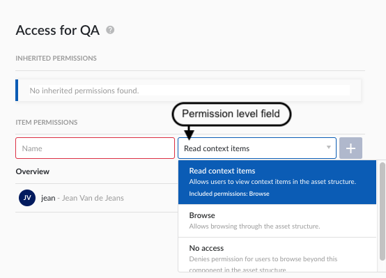

    An asset access panel appears on the right side of the screen. Here you will see any inherited permissions on the selected item. To add access rights:
  4. Type the name of the end user under the "ITEM PERMISSIONS" heading, for which you want to provide permission for.
  5. Select individual.
  6. Look to the permission level field, and select permission level.
  7. Click on the plus sign.
There is an overview dropdown which provides a description of the permission levels available. Three permissions levels are listed:
  • Read context items: allows users to view context items in the asset structure (included permissions - browse).
  • Browse: Allows browsing through asset structure.
  • No access - Denies permission for users to browse beyond this component in the asset structure and hides the context data attached to these items.
