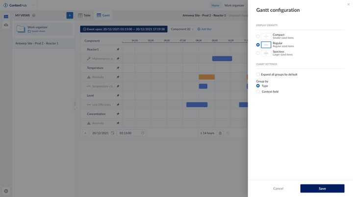

Display density
The display density of the Gantt chart refers to the level of bar compaction seen on the chart. There are three settings: compact, regular and spacious.
First display your Gantt chart on screen, then:
  1. Click on the gear icon at the far right of the Gantt timeline heading (Gantt settings).
  2. Select a display density.
  3. Click "Save".

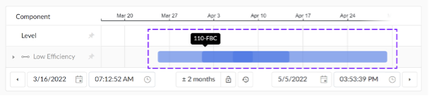

When you hover over an item on the Gantt chart, underlying context items are contrasted from the top layer.
By clicking on the item a dropdown list of items appears.

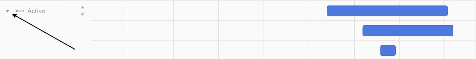

You can also expand the type by clicking the small arrow situated in the first column of the item. All layered items are now located on their own row.
Expanded rows are organised by start time.

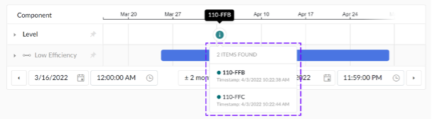

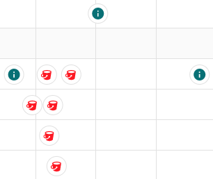

Instant context items are items with a single time point signified on the Gantt chart by an icon; for example, an information icon highlighted as an (i) in a small green circle.
The same principles as with the overlapping context items above apply to the overlapping instant items as well as context item fields.
  • Click on individual instant items to open the associated context panel.
  • Click on the arrows located in the row headers to expand overlapping instant items / context fields.
  • Scroll over a cluster of icons and click, a dropdown list will appear providing a list of all instant items in the cluster.
Info items have no overlapping solution currently.

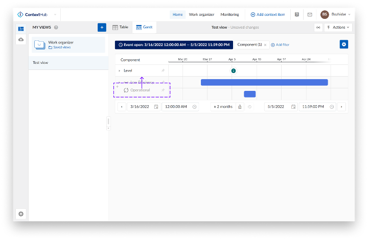

Gantt sort refers to the order of the Gantt components and types displayed on the table. Gantt sort enables you to move the context components and types into an order of preference. By default new context items are added to the bottom of the Gantt.
To sort the context items:
  1. Look to the item you wish to move.
  2. Drag the context item type/component name, up or down to move as desired.
  3. Save the sort conducted by clicking on the action button.
  4. Click "Save" in the action drop down.
Gantt sort occurs on two levels; the type level and component level. You can drag and drop the type name to move the type up or down the table as required. Sorting on the component level sorts the component as well as associated types. For example, if you have a pump component with various types associated, such as an anomaly, equipment failure and cleaning types, the entire package moves with the component.
With any alteration to the order of the components and types, the view definition changes to "Unsaved changes", so you must save after the selected component/type moves.

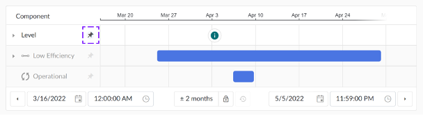

Pinning a row to your Gantt chart, means your rows will always appear in your Gantt chart, even if there is no data available for the combination of set filters.
To pin a row, simply click on the pin situated to the item of interest. A dark grey pin denotes an item as pinned to the Gantt chart.
You can pin components, types and fields.

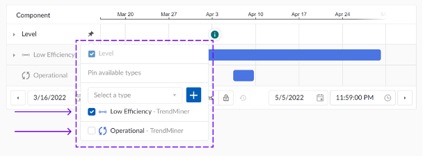

If you pin a component a popover appears.
This popover lists the component types that are currently on your screen. Pin available types under the component by checking the boxes. By unchecking the boxes you remove the pinning action.  Using the search box, you can add additional types that are currently not on your screen.

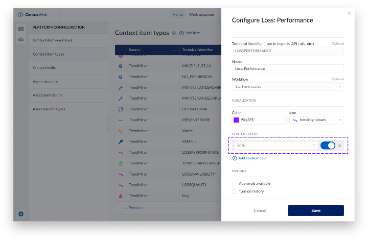

For ease of identification the bars on the Gantt can be specifically labelled with identifiers that enable simple differentiation between context types.
Labelling of this type is controlled in the edit type detail page.
  1. Goto ContextHub and click on the  Configuration button on the top right of the UI.
  2. Click on "Context item types" in the "PLATFORM CONFIGURATION" menu.
  3. Select a context item type you wish to have a field label, and click on the three vertical dots located on the right side of the type row.
  4. Click on "Edit type" in the drop down menu. A side panel will appear from the right.
  5. Under "Context fields" select the items you wish to add a label on the Gantt, and turn the associated toggle on.
Now the identification is displayed on the associated item Gantt bars.

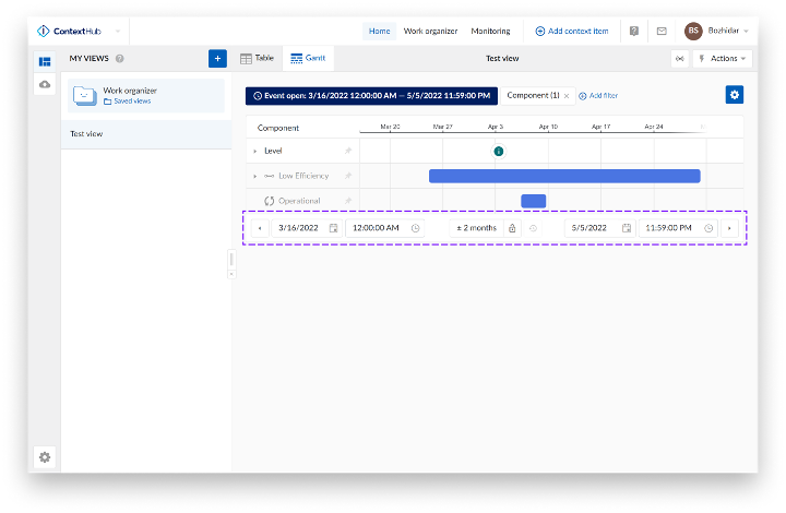

In the Gantt chart, you can now easily manipulate the time span you wish to analyze using the navigation bar, positioned at the bottom of the chart.
  • Lock button: Use this button to lock the currently selected time span.
  • Undo button: Reverses the last action made in the Navigation bar.
  • Arrow (left / right) icons on focus chart: In regular (unlocked) navigation mode, these buttons add 20% of the current window size. When the time span is locked, the buttons move the chart (left/right) also by 20%.
  • Date and time pickers: Use these buttons to select the start and end time of the Gantt chart.
  • Fixed span selection: By selecting the time span picker, you open the option to apply preset time frames to the Gantt chart, to enable a quick and easy way to frame the time span you wish to analyze. These time frames include 1hr, 2hrs, 8hrs a day and so on. Included in this time frame selection menu is the possibility to enter specific time periods. Simply select the exact period you wish to see displayed in the Gantt chart, and press enter. The period picker also enables the manual input of a period from weeks down to seconds. To input a period simply use M for month, w for week, d for day, h for hour, m for minute and S for second.
