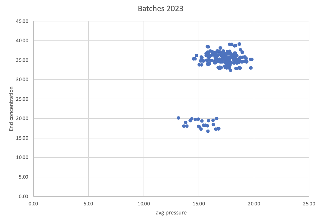

Search result calculations can be exported to an Excel file, where they can be analysed further. An interesting workflow is to calculate multiple values for a set of features, to then see how these values correlate. This way we can easily test a hypothesis that two calculations should be correlated. The most straighforward approach is to create a scatter plot in Excel of these calculations, and visually confirm the correlation.
To test our hypothesis that a lower pressure during a batch leads to a lower end concentration of our product, we search for all batches of this year and add the average pressure and the end concentration as search calculations. Exporting to Excel and creating a scatter plot shows most batches fall in a group of high pressure, high correlation, but there is another group with significantly lower pressure and concentration. We could say our hypothesis is confirmed, though we should note that within one group, there seems to be no further correlation between pressure and concentration.
