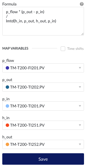

In general, a performance tag is a calculation that we want to have as high as possible, and of which we would like to know if it decreases. The calculation needed to create such a tag is very dependent on the process.
The heat exchange coefficient, calculated from product and hot water flows and in/outgoing temperatures. For heat exchange, we can use the built-in function for logarithmic mean temperature difference. Note that if would like to have the resulting tag in SI units (W/m2/K), we would need to include a correction factor in the calculation.
![[en] Heat exchange coefficient calculation](image/uuid-7f6a676d-cbff-d4ee-0da4-b480358eaa03.png)
